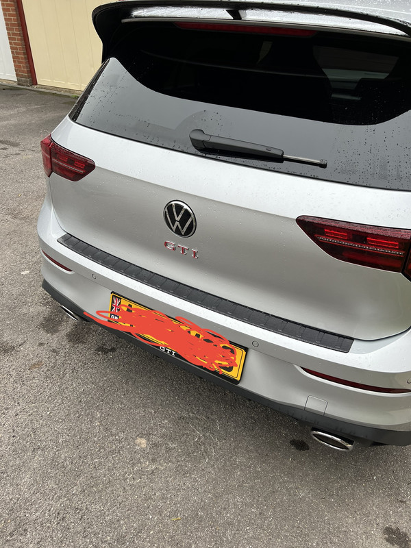

I have the rear carbon effect bumper protector fitted. I think it looks fab.
